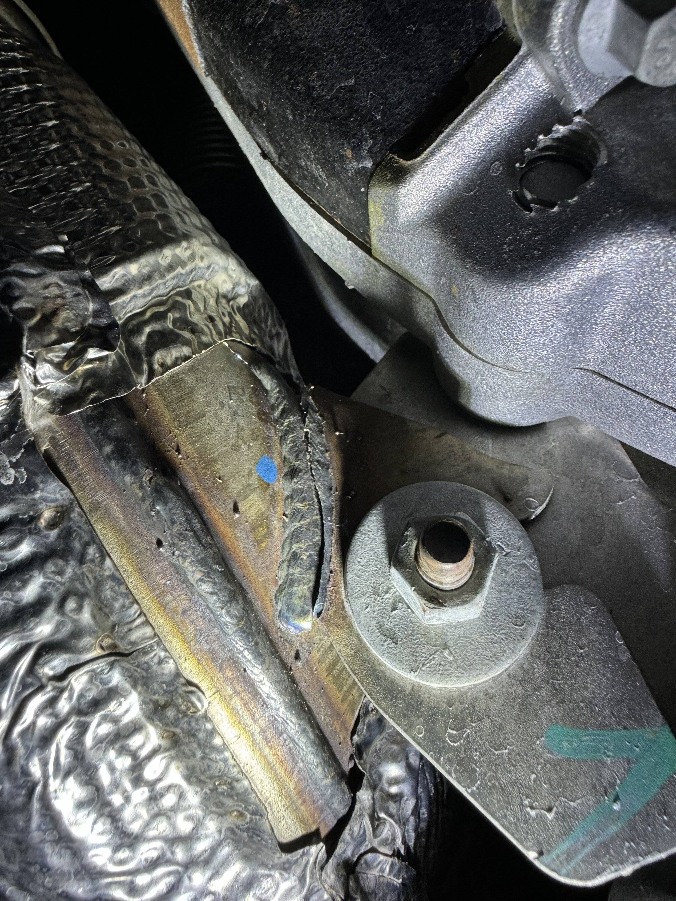

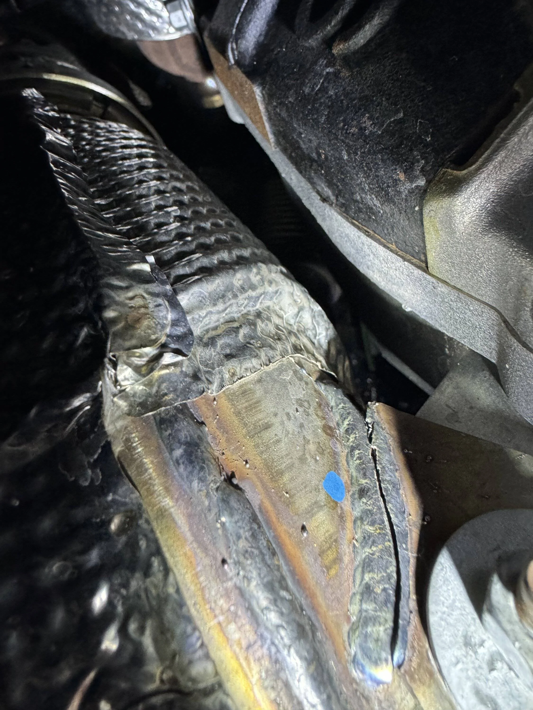

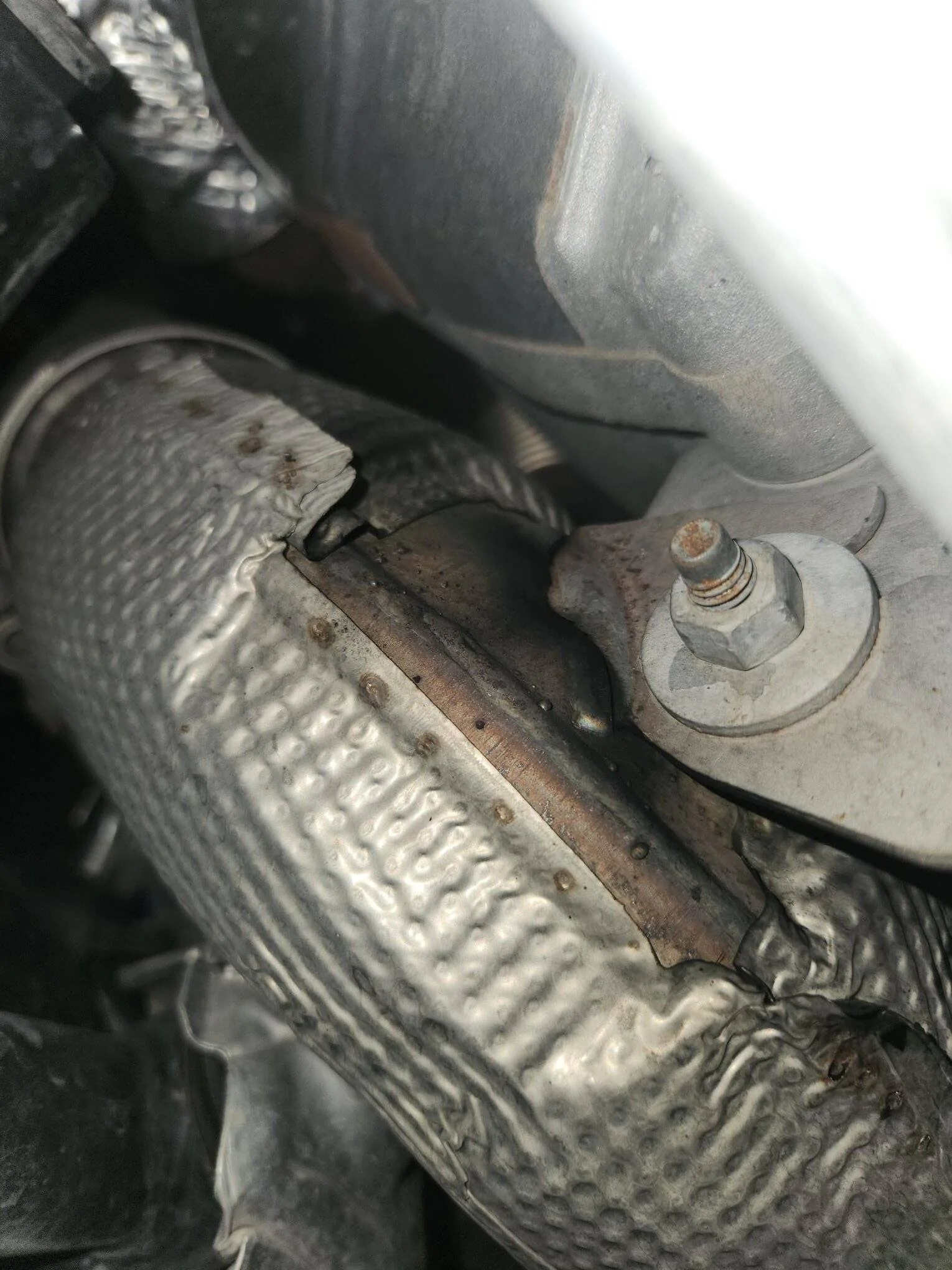

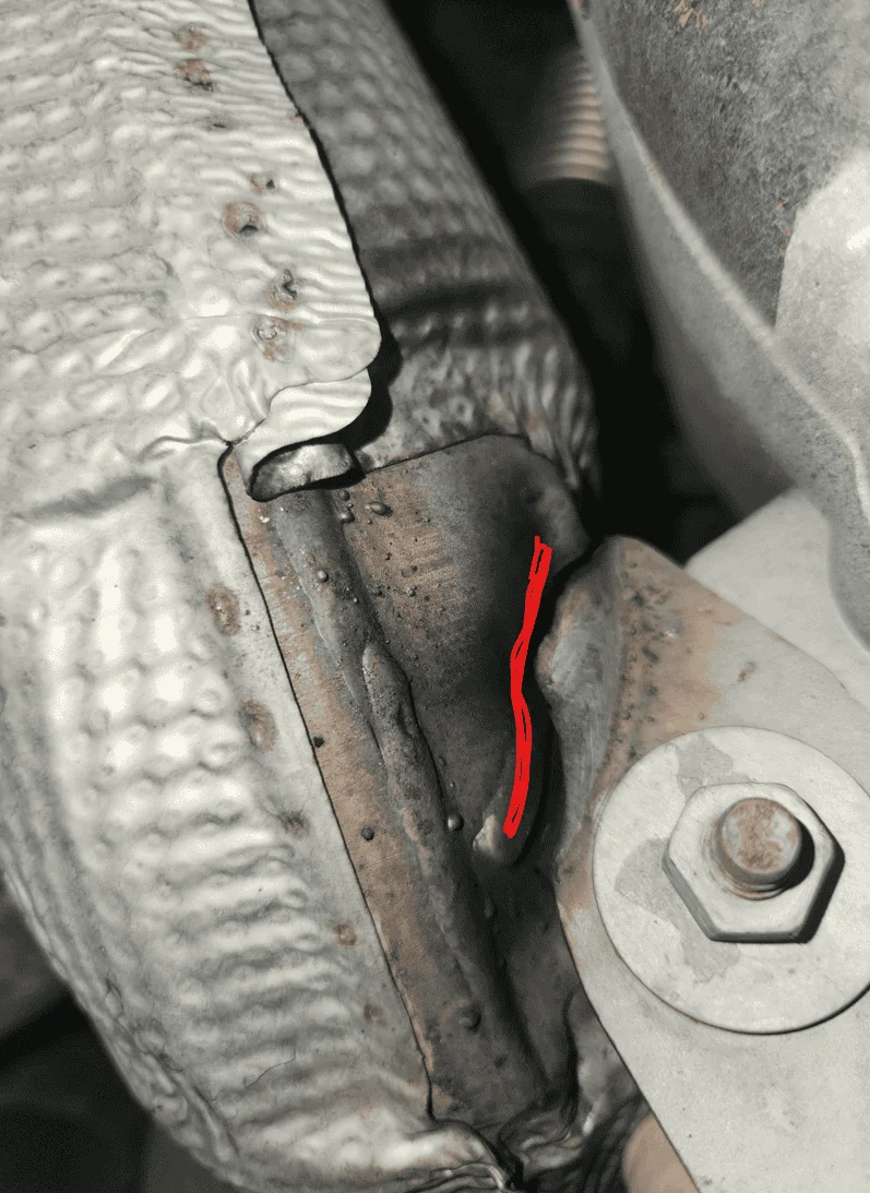

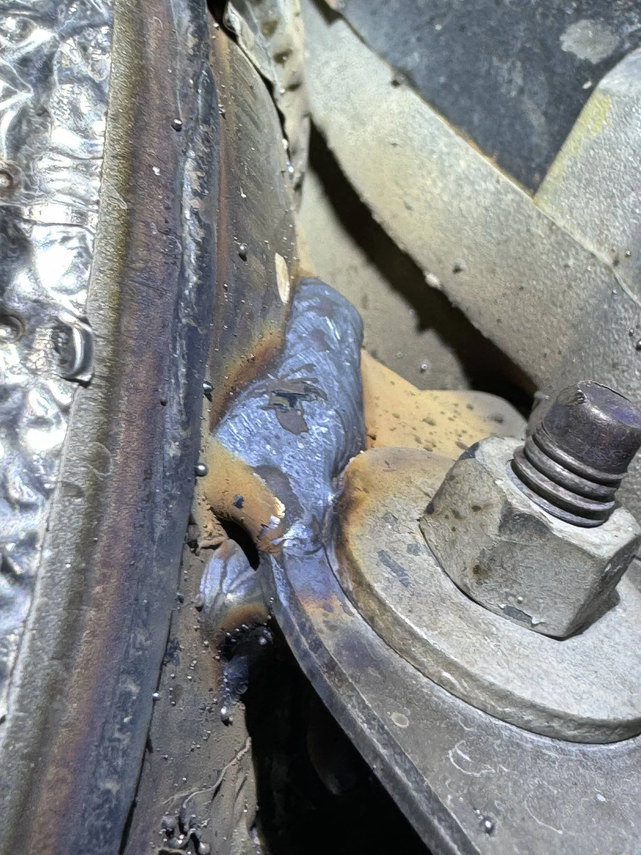

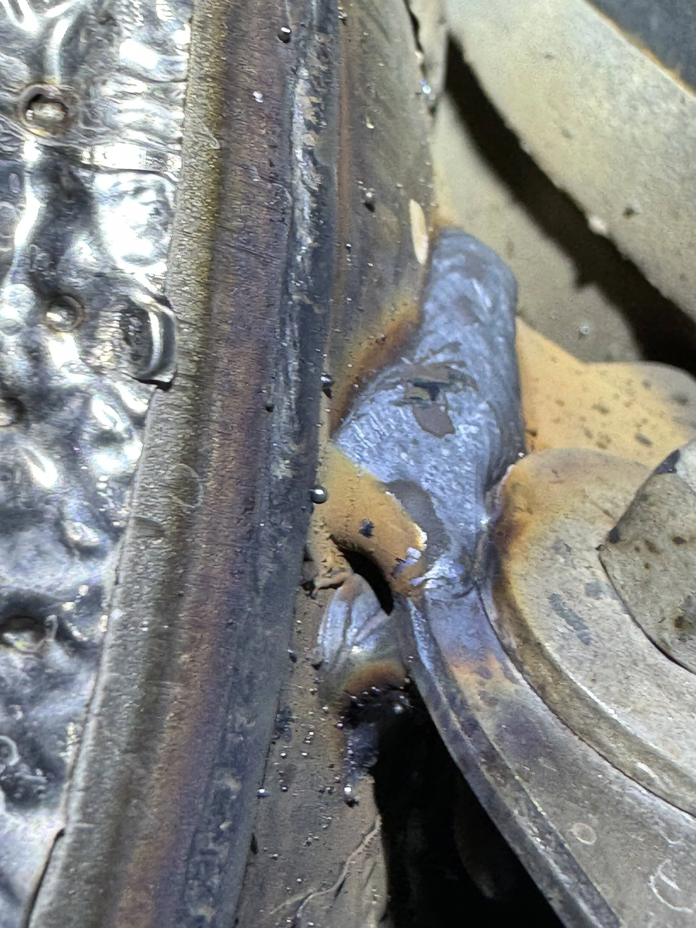

- 2021 JLU 3.0 Diesel

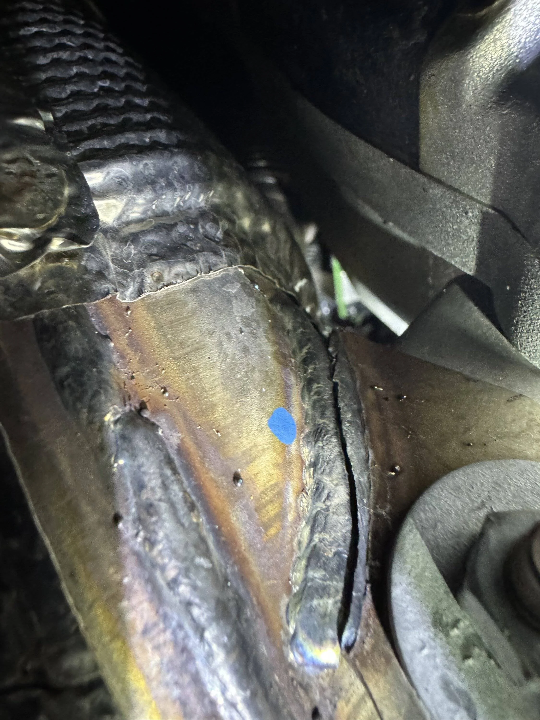

I want to thank everyone for the responses. I have a 2021 jlu that started the rattling noise only when it was idling. Looked on this forum and diagnosed it. It also had a weld break at the exhaust. I appreciated the photos and description of where to look for it.Welded it back with no other problems. This has saved me a lot of worries and I don’t have to take it to the service department now. BIG THANKS!!!Check your exhaust. I had one of the brackets on the exhaust break at the weld. Go under the front passenger's side on the Jeep, that's where mine was.
