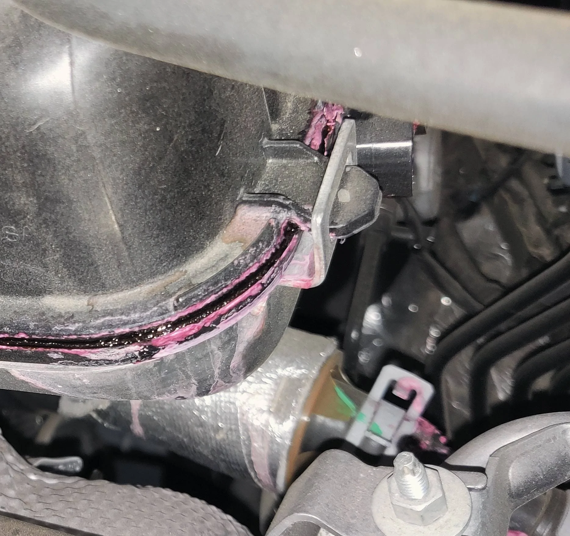

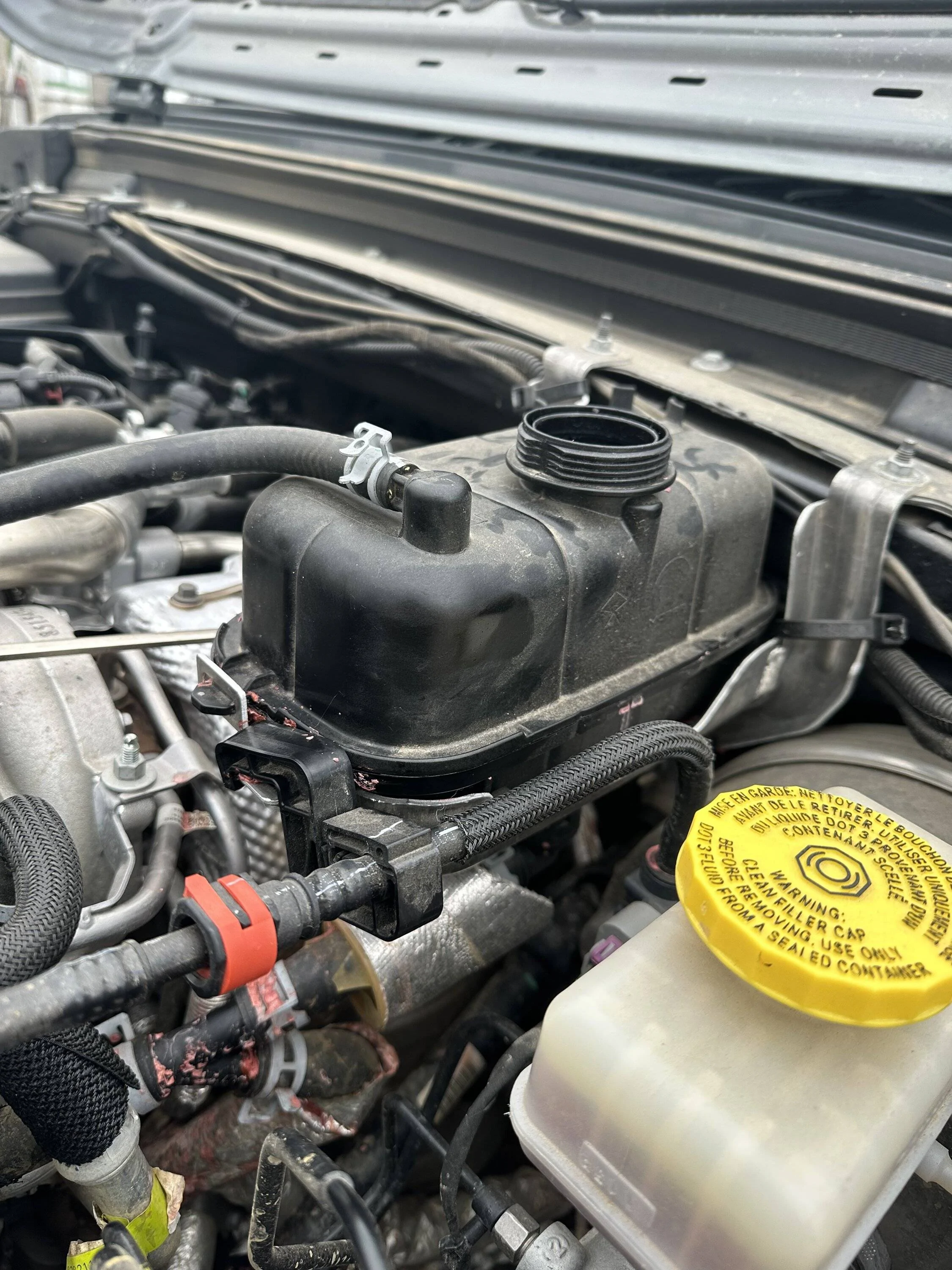

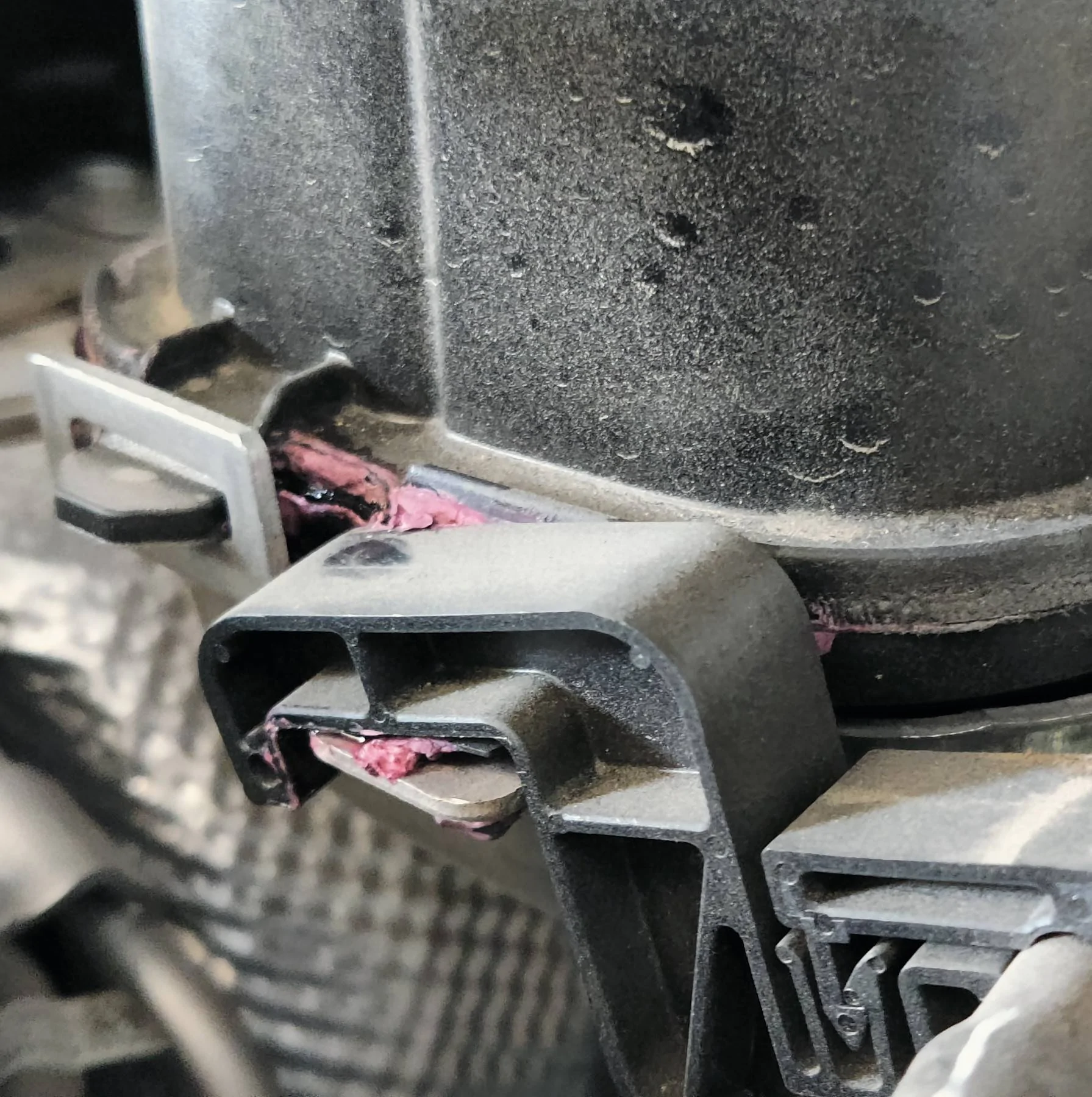

Took it for errands this morning. Short trip, maybe 10 miles. After parking it, smelled that recognizable scent of hot coolant. No visible fluid puddles underneath. Decided to check on it when it cooled down.
An hour later, I popped the hood open and found dried coolant on the reservoir(firewall).
Can't get it in the dealer till Thursday. Oh well. Good thing, we have another ride to get around.

The expansion tank is splitting open. You need to fix that right away. Last week seen the same thing on a customers Jeep.

Dropped the Jeep off at local dealer last Thursday. Yesterday, they finally had a tech come up with the same diagnosis as we can visually see. Now, I have to wait 3 days for the part to arrive. I'm gonna have to follow up to ensure they do a proper pressure check as well to ensure nothing actually caused that failure asede from possibly just a defective part. Hopefully the dealer doesn't run out of the coolant needed to replenish.
On that note, we have to wait for a few more days. Just really glad I noticed it before any significant damage occurred.

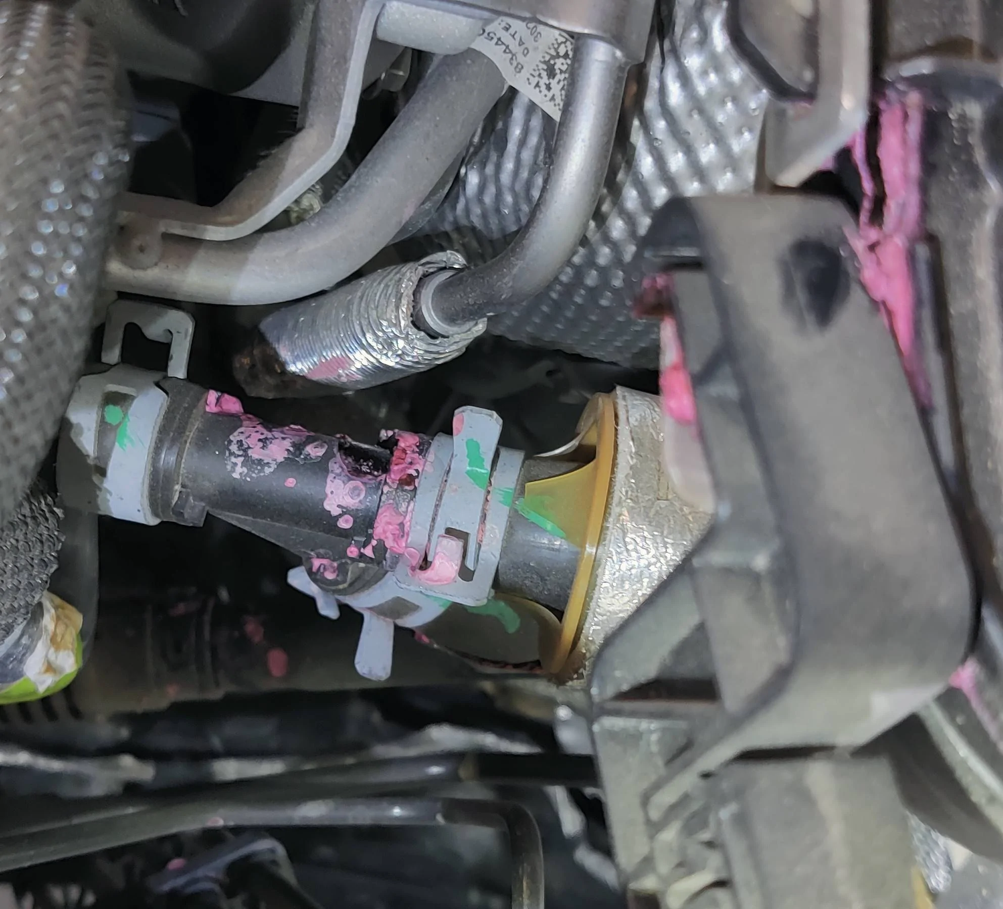

Did my own Wave service yesterday and noticed it happened to my 2 door as well. Coolant level is at the MIN line on the dipstick which is curiously at the same height as the reservoir’s seam.
My theory is coolant has been escaping as steam through the seam when it’s warm but haven’t noticed until it got cold. Have added coolant in the past.

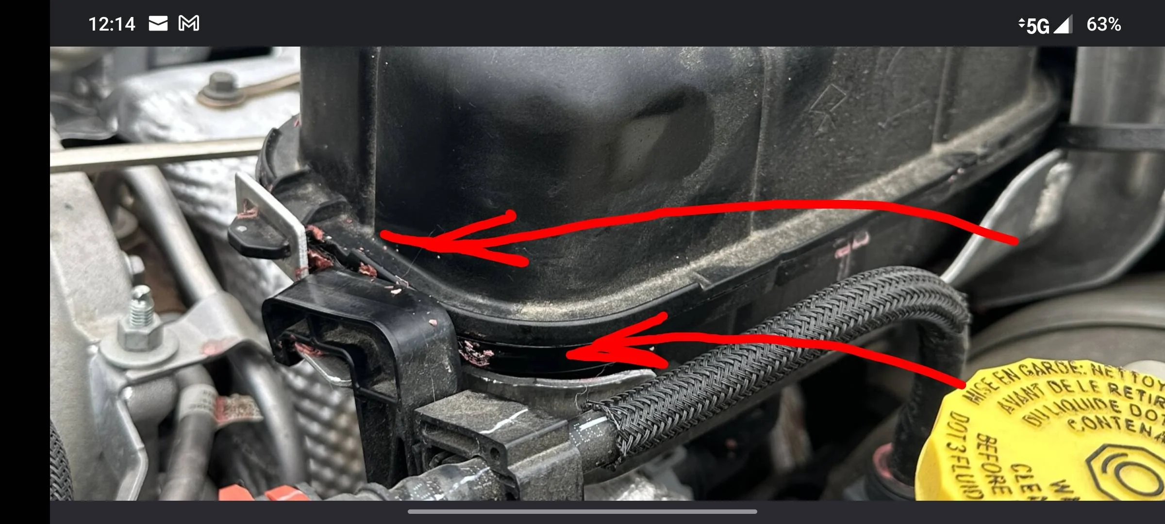

Just a suggestion...
Get that looked at. The purple residue is dried coolant. Possibly the two halves of that reservoir are separating.
I had mine replaced in Oct 2o22 did to cracking in the same area. I had to wait 2 weeks for part to arrive.
