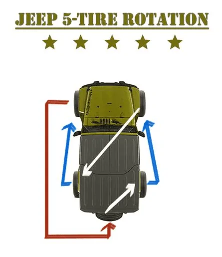

I do a five-tire rotation every 5,000 km.
As an aid for the technician doing the job I chalk the location where the tire should end up. For example, on the spare I will chalk FR on the spare side wall. This also helps you check that the job has been done correctly when you see that every tire is in the correct position.
EDIT: updated tire rotation diagram to reflect the
Rearward cross for rear-wheel drive or 4-wheel drive

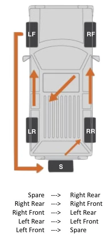

I rotate every 5,000 miles with oil change and do five tire rotations. Your tires will wear longer (20%?) and you're not stuck with an odd tire when it comes time to replace them. There are several rotation patterns out there. This is the one I use.
This is actually the "forward cross" rotation meant for front wheel drive vehicles. The "rearward cross" method is recommended for 4WD vehicles. See cb4017's post above.
This is the recommended rotation method for 4WD vehicles. Nice graphic!
