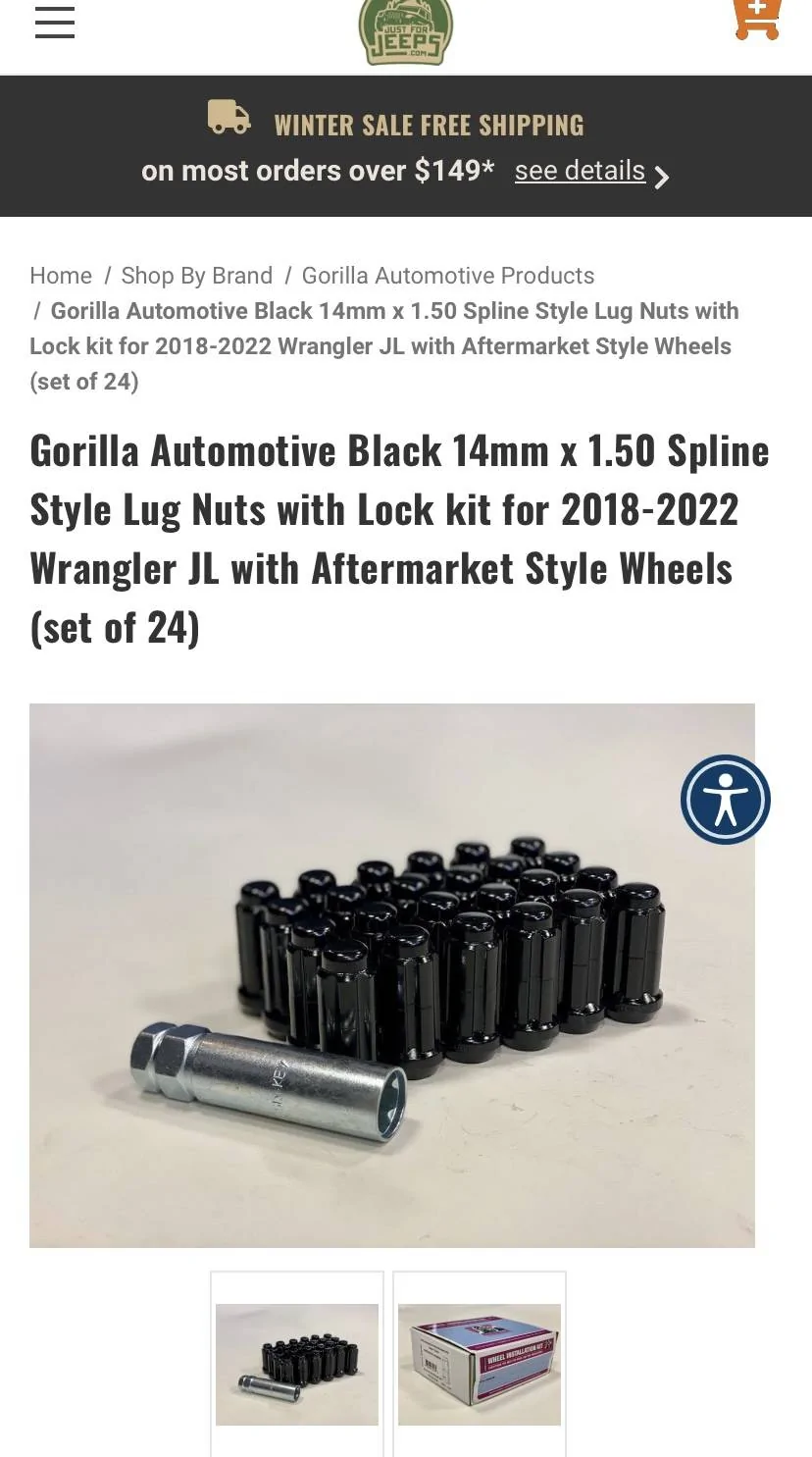

Jeep Wrangler JL Wheel Torque Specifications JL/JLU 4B1B4EEA-31F0-487A-89DA-A5DB147FECA5
Those are great…and if using these I wouldn’t even have asked about a possible different torque spec. These are larger and very similar to the factory acorn lugs.
But I’ve had to purchase the actual skinnier spline lugs in order to fit the lug holes on my aftermarket rims. (Fuel coverts)
This is what had me questioning a possible different torque recommendation.
For reference these are the lugs I had to go with for my aftermarket wheels (Edit: shown above)

Here's my thread from a while back regarding crap spline lugnuts vs. decent spline lugnuts, vs. even better full 6pt lugnuts. As long as the seating area of the lugnuts is decent you should be fine at the factory 130 ft lb spec.
https://www.jlwranglerforums.com/forum/threads/looking-for-better-safer-lug-nuts.43461/
Yea I saw your thread brother….I read it and looked into your recommendations …unfortunately these wheel lug holes are smaller than factory wheels, so the ones you guys went with wasn’t suitable for mine.
