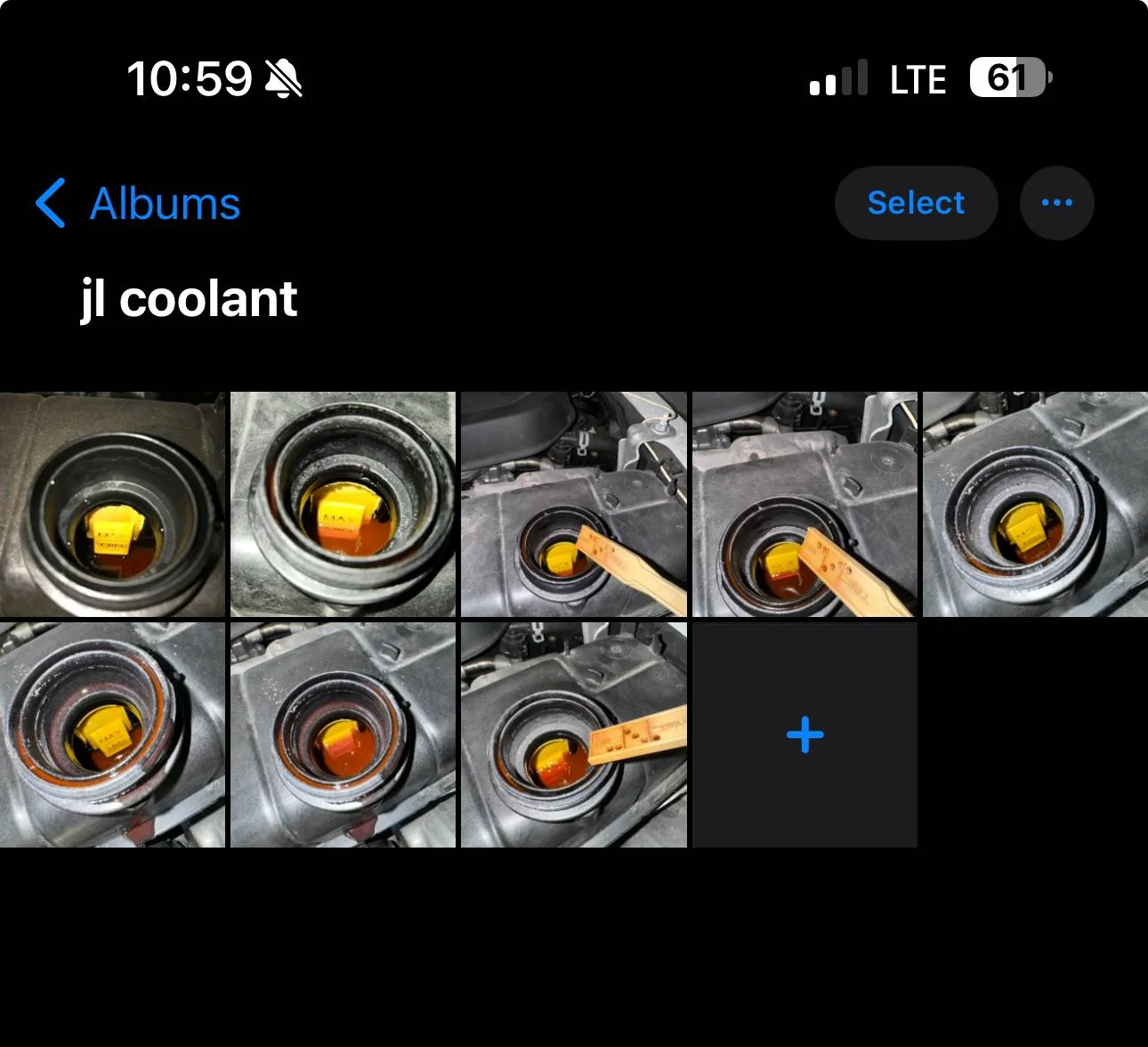

The really stupid part is that when I had mine replaced via the TSB, they replaced the semi-transparent reservoir with the newer full-black one. So previously I could glance and check it, now I have to remove the lid and somehow awkwardly gaze into the reservoir (which is right up against the back of the hood). Basically have to use my phone camera to get a good look. So stupid.
I feel that, I have a whole photo album saved for keeping track of it :CWL:
Jeep Wrangler JL 2.0L coolant reservoir leaking IMG_3192
